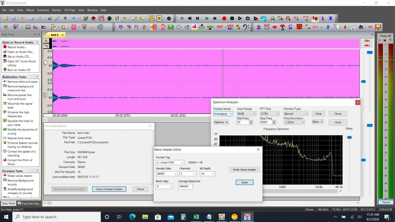

        Click image for larger version  Name:	Untitled.jpg Views:	44 Size:	144.9 KB ID:	54714 If you set it for 96/24, it will indeed record at that rate and that bit depth. What you do not know is whether or not they are emulating the higher sample rate. Here is a pic of what the Realtek audio chip-set does on this laptop; it is indeed 96/24. It just adds samples in - between samples taken at a lower rate. So, I do not have the true bandwidth advantage of the 96 kHz sample rate. It actually looks like it is sampling at 48 kHz and adding an extra sample of the same value in between sampling.
          Note the brick wall at around 22 kHz on the spectrum analyzer shown above (the vertical line), despite sampling at 96 kHz. My Edirol recorder when set to 96 kHz shows a brick wall at around 47 kHz, which is what one would expect.
