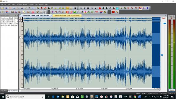

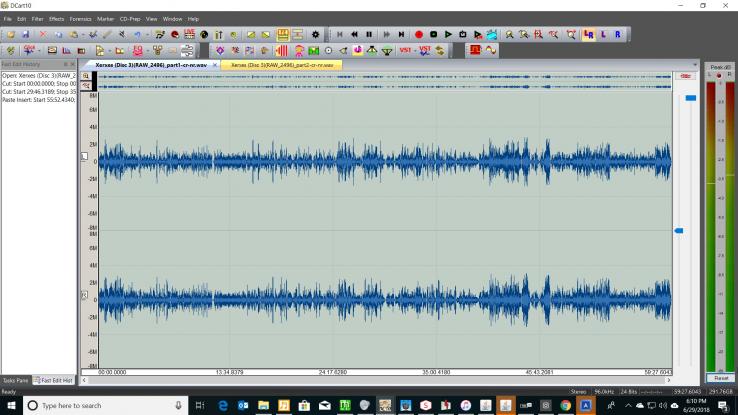

ID:	53935 The left example is after appending the two files, but before saving. The right example is after saving and normalizing. The save did not produce the corruption this time like it normally does, but the normalization did.
