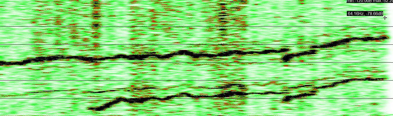

Is this the kind of 60hz signal you would see with a rim drive? It is a mono recording from 1963. It sounds a bit fast.
The top line starts at 62.2Hz and ends at 63.3 Hz, 23 minutes later.
I am not familiar with rim drive reel to reel recordings. However, I would guess that the motor speed would remain relatively constant assuming that the batteries had not been drastically depleting during the recording process. Thus, the take-up reel speed would also have been relatively constant. So, if the take up reel speed is constant, then the tangental velocity of the tape would tend to increase as the take-up reel filled up. So, if that is true, then I would think that the 60 Hz signal would do the opposite if played on a regular capstan based reel to reel player (60 Hz would decrease as the tape progressed in time). But, the spectrograph shows the opposite, so I am not sure about it. Maybe the batteries were failing during the recording creating the opposite effect. At any rate, I am guessing that the speed could be reasonably corrected with the non-linear speed change filter.
Thanks. Yes it's not difficult to correct. I just get curious about these. So a rim drive would sound slower if transferred with a standard machine. I was thinking this was probably batteries. I had a small battery open reel when I was a kid,and battery drain was noticeable
very quickly.
I guess it could be the discharge curve of the batteries creating that 60 Hz contour, especially if those types of recorders were real power-hogs (guessing that they probably were).
I would imagine an early reel to reel portable rim drive recorder would be very power hungry; it would probably draw much more power than a cassette recorder due to the amount of motion involved and the higher mass of the tape. Also, the amplifier circuits from those early days would not have been as efficient as those found in the early 70s on portable cassette machines.
