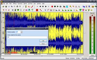

              When I click on marker "01" it turns black. When I right click on the black marker, I get the Label Marker pop-up. I change Marker Number "0" to "01"; then, I go down and delete "01", and change it to the Track Title "Turtle Talk", and the marker does not change in the wave file.
              Why, when I click on the marker "01" (assigned by the program), does the pop-up show marker "0"?
              What am I doing wrong?
                I am still a bit confused but I think I see what is confusing you here.
                In the "label marker" dialog box there are two fields "Marker number" and the Marker Label field.
                The "Marker number" field selects which marker you are going to change. It starts at zero "0" as the first marker in the file. It is not something that you enter as a value to select the marker.
                So to label your first track as "Turtle Talk" you would select marker "0" and change that label.
                Markers are automatically renumberd so that marker number zero is the first one (in time order) in the file.
                Initally, when you first add a marker, it will have a label that starts at "01", but this is actually marker number "0", which is probably what is confusing you.

                  What's giving me my problem: When I start out with marker "01", the program skips the zero, and makes the next marker "03" (the beginning of an incorrect track). It skips over the zero.
                  I am trying to use Diamond Exclusively, and not transfer the file to another program to insert the Markers, I add 1 sec. silence before and after the marker. Then I can burn my CD's with no problem.
                  I really like the Diamond Cut Marker function better, because it adds the Marker and automatically adds the 2 sec, needed for indexing.
                  Have I made this too confusing for you; or do you understand my problem? It's probably too dificult to reorient the Forensisc to use the "01", as a zero point... Another problem I have, when I Label the Marker, the Label covers the Marker; and, when I automatically Renumber the Markers, the last marker "End", never seems to be the correct last Marker. In this particular file, I have 12 Tracks, and the "End" should show as "13"; sometimes it will go as high as "22", and I can't see the markers, to figure out how to correct them.

                    It looks like this problem was caused by two markers being placed on top of each other. So when the re-number marker function was used, marker 02 was underneath marker 03, and therefore not visible. Without actually movng marker 3, it would be difficut to tell that this happened.
