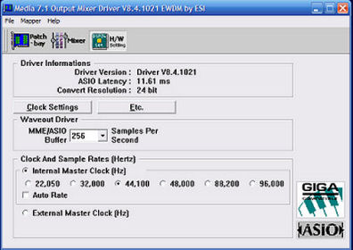

    BigAl , I have a Media 7.1 card , and I found that if I let it choose what sound
    bit it wanted for the computer system, it chose something like 16 bit 22.5 hz , and when it did that my sound was quality was terrible. So my question to You is , what is the soundcard clock rate set at ?
    If Your card is set at " Auto Rate " ... try setting the clock to 44.100 hz,
    I hope this helps , here's the window panel for my 7.1 card.
    Cheers, Stephen
