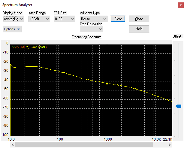

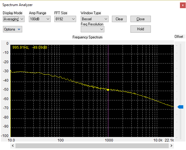

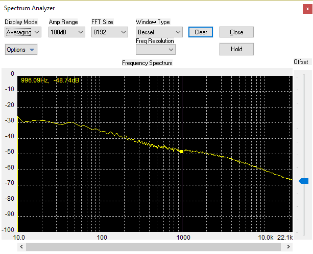

    It does look like there is a +6dB gain difference in the VPA at 96kHz vs 44.1 and 48k. It seems to be just an overall gain offset, not a different curve. I can fix this in this upcoming release.
    96k Click image for larger version
    48k Click image for larger version

    44.1k Click image for larger version
    The sample rate conversions are pretty darn good, especially if you do a master quality conversion. Almost no detectable difference except a slight roll off about 20kHz. The CD quality conversion does have more roll off.
    As for the time difference, there will be some difference. I have not looked into the numbers you have here to see if that is excessive or not.
